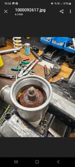

Just an update shocks are with lukasz at t-tech suspension pictures will show why my damping control was not working lol. Also springs I always thought could be tatty but still work but mine are shot and need replacing at least they will come back and work like new.

Just an update lukaz at t tech suspension sorted my shocks out and fitted new springs, been back on the bike a couple weeke, difference is incredible works in every setting now of damping makes the bike a pleasure to ride i just got to.sort my screen out now and.should be sorted. Cheer for the advice.and putting me.on the path to t tech 👍
