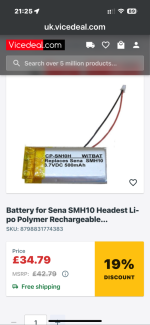

mine did that when the remote battery needed replacing. i was in scotland with mates earlier this year and the sound dropped and i couldnt get it up then it cut out completely.
note i did try factory resets x10 / firmware updates etc then a new battery and it worked perfectly.

Thanks Barry but isn’t it odd that 2 units should die at about the same time?
Only personal experience but I’ve had to replace both my 10R’s because the soft plastic covers on the control unit cracked and gradually disintegrated. I did a bodge repair on one whilst I was on tour by gluing a piece of bicycle tube over the top.
It may be worth checking yours to see if they are letting water in that way.
I’ve also replaced batteries in the past.
