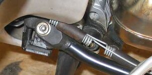

Yosi,
The plug is on the left side and as soon as the seat is removed it is very visible.
To by-pass the switch I just used a piece of bell wire to go across the male part of the plug. I formed the two ends to fit by wrapping around a small Allen key (hopefully the picture will show what I mean).
You don't need too much or else the connector will not snap closed again.
This is probably sounding more complicated than it is but it really does only take about five minutes to do.
The actual switch on my bike ('97 1100) is immediately below the sidestand pivot bolt.
Some people disconnect this and solder the two wires together to achieve the same as putting a jumper across the connector.
Hope this is useful to you but if not, just ask again.
