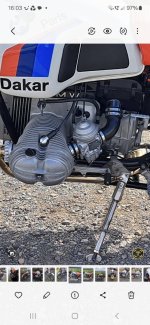

I took some pictures prior to the Migsel collapse, nice bike. Anyone know what gear lever that is?

I’ve got a Bob Porrecha side stand fitted to my old R65, the stand is 28 years old, it’ll last forever, and it’s what Migsel copied but it seems better made :D … I think I’ve another one in a box somewhere in one of my lock-ups :D
Do you know if the owner used the side stand when mounting/dismounting?
The gear lever looks homemade - I made something similar on my R80G/S.
Er, I think most people use a side stand as they get on a bike and deploy it before getting off? Do you mean did he climb on the footrest and mount/dismount like a horse? No. I was standing next to him when it happened - he got on the bike and got ready to leave (stand retracted) and then dropped his glove. I didn't notice (I was on his RHS) as I would have picked it up for him. The next thing I knew he was on his side under the bike after deploying the stand again ready to get off to pick up his glove. I thought he'd forgotten to put the stand down! But it broke.
