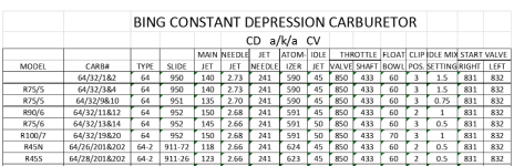

I had these set as per the Bing recommended settings (1/2 turn on idle mix setting) and didn't have this issue so not sure what has changed

I didn’t replace the slide needle or jet seat as they looked ok but bow to Mikes far greater knowledge that even though they looked OK they could be worn . Needle clips were installed as per Bings recommended settings . Some dirt in the carburettors is quite possible as the transporting of the bike could have dislodged some dirt in the system
