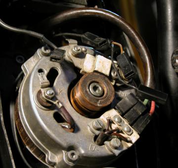

Anyone got a numpty list of what goes where on the diode board for a 95 para?:augie

The three large wires from the alternator go to the three connectors on the back of the diode board (in any order)
The blue wire goes to either of the remaining two terminals on the back of the diode board
The large connector to the battery goes to the large connector on the right of the diode board.
The black wire goes to the alternator.
There should be two brown wires that connect to the engine case and to the top of your rubber mounts to earth the diode board. If you connect these to the wrong rubber mounts you really will let the smoke out :D If you pick up an early mono timing case it gets rid of the rubber mounts completely.
Morning Rob... not going well...
I have 4 wires, apart from the 3 wires for the phases and the blue at the back of the board. Batt. wire is on the r/h terminal, viewed from the front.
There is a short length of black wire, currently attached to the l/h side of the board. A brown and a black in their own harness and another black.
I only have 3 terminals left on the alternator:nenau - top, left and right.
should the brown go to ground? Where?

The brown and black pair (one of your black cable that's disconnected) go to the brushes on the alternator. Your brown wire needs to go to the left hand terminal otherwise It will not charge.
The slightly larger black wire goes from the left hand side of the diode board to the Y connector on the alternator stator.
I suspect the single black in your picture has pulled off the starter motor. It should push through the back of the timing case and goes to a terminal on the starter solenoid.

Exactly that. Thanks:thumb2
