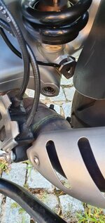

Evening all. Heading back to blighty tomorrow. The other day I took a long look over the bike before I load it full of food etc and ask for it's usual faultless service.
Referring back to my mechanical neurosis and the vibes. I got a socket to the claimp on the silencer side of the exhaust and discovered I got a at least 3/4 of a turn out of it. Expected little to nothing. So kinda hoping this has been the cause of the little vibes I've noticed. Will find outt soon enough tomorrow!
In the meantime, below is a pic of the previously mentioned greenish residue around the silencer side of the exhaust that got me wondering in the first place.
Sent from my SM-G975F using Tapatalk
The book says to grease the exhaust clamps. Presumably to help the clamp spread the load around the exhaust. So that might be the residue from the grease, which I think, if my memory Is correct, is that Starburags NBU 30 lubricating and assembly grease which if you’re not familiar with is white in colour.
I notice that you have no cover on the exhaust flap valve. So I take it you watch it cycle during the start cycle. It’s normally spring loaded open and the actuator controls it’s closed position. Mine seized at half closed or half open depending on one’s perspective, I was glad to get rid of it for a through pipe.
:thumb2
Ian
Ian. Thanks for that feedback. Quite useful because I didn't use any grease surround the clamp 'ring' at all. I put some on the dowels/bolt threads as they get a load of weather and heat cycles.
I did though stuff some nickel grease into wherever it would go on the flapper pivot when I had the silencer off. I'm thinking (especially with your comment in mind and that I didn't grease the clamp) the copper or even nickel in the grease I stuffed in has been able to make it's way out and left that halo. Bit of a long shot greasing that pivot tbh, incredibly harsh environment in there!!!
But the good news is, the micro vibe has gone. So for the moment, I'm thinking it was that
Next time I have that assembly off, I'll be lightly greasing the inner face of the clamp! Thanks for the tip
