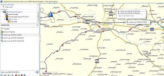

Awesome outing following another 'Tosser' through mid Wales. Places I've never heard of let alone been. There were 3 stops. NAV V recorded 1 full track of the day, and two parts of that track.
Question 1
When you stop on track, switch ignition off, at what interval in time does NAV V make that a hard stop in recording? I.e. It becomes a part of a the day's track so you will need to stitch them all together to make a route. It seems odd to me that I had a full track and part tracks when I downloaded to basecamp?
Question 2
The full track actually had a straight solid grey line for the last 10 miles of the track as well as the actual track I took which was dotted. Converting it to a route I was unable to take the solid line out as it was somehow connected, so deleting it meant I lost much of the route. Why would it create a straight line? I didn't fly!
In the end I used tracks as a template and created a new route over it, but not very efficient!
Comments, piss takes welcome. And no I didn't have cross country on.

Thanks Wapping. I'm using a PC. The bike stopped 3x, switched NAV off, with a max interval of say 15mins. So does that split the day's track? Is the software designed, to do that? As well as keep a full track of the day?
Re the straight line, who knows, but bloody annoying. In PC you simply download data to basecamp and hey presto you see the tracks for the day in left menu. I didn't need to make an adventure. I clicked on the track and created a route from. Simple. If it had worked of course. I'll get some screen grabs.

Hi Wapping,
Just for your interest. The trick I found was to go into the original track. Mak any changes and then save to route. I did notice that once in route you have no shaping points. To make any future changes you create a track from it.

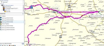

See that straight line though. Without that it would have been a 2 minute job to save the route. On the plus side it did self train me to get rid of that rubbish.:thumby:
GlennT, not having the actual file and also not being able to see the route close up, but could you not have selected the move point tool in basecamp and gone to the end of the straight line and moved it to the start of it, or on to a point elsewhere on the route. Like i say without having the route its hard to see what has occurred and to suggest a way around it for future reference. You could try and post a link to the problem route.
It seems from the screenshot that the device has, for some reason or another, created a straight line track between:
1. A random point (marked with a blue flag) to the west of Shrewsbury, slightly to the west of your actual route, that took you west northwestwards
And
2. A random point (again marked with a blue flag) slightly to the west of Apley
The track also shows that your ride between roughly Maple Brace (?) and the blue flag at Apley was circular, by which I mean you rode from roughly Maple Brace up to near enough Apley and back again.
For some unknown reason the device created a west to east track between the two blue flags but lacked any breadcrumbs to do it properly, hence the straight line. In parallel it also created a correct track of your actual journey. Interesting or not, the tracks appear to be timed one second apart.
Something happened at either or both of those blue flags, sufficient for the dumb device to create a false track west to east between the two points. Why the two blue flags are there I can't imagine, did you create them either on this journey or at some time in the past? The blue flag to the west of Apley might make sense as it appears to be where you turned around, perhaps? The one to the west of Shrewsbury seems to have been created by error; by whom, what or why.... A mystery.
Garmin are quite good at solving some mysteries. Why not contact them and send them the track file, along with as much other detail of the ride as you can. See what they say. They'll also be able to answer your question over the timings / circumstances behind track segment creation.
In the meantime, share you track file with us. Host it on Dropbox or something similar so we can download it. Of, if it's a small file or can be compressed to within the site's limit, post it here.
PS There's lots of good information out there on how to edit tracks. Some of it might help you sort out the removal of the straight line very easily.
Thanks Wapping. Appreciate the in-depth reply of possibilities. It is a mystery. I have since corrected the offending straight line in tracks (good training). Rather than go for an autopsy on this I shall see if I can replicate the problem.
