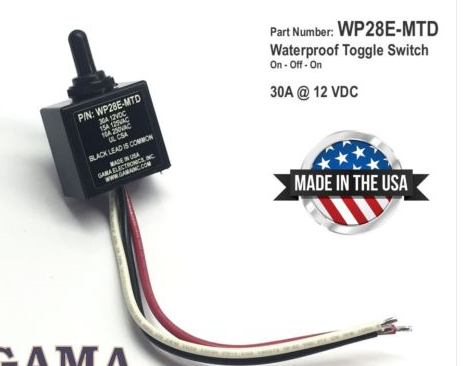

If you cant get a feed because of the canbus system you could just install a handlebar switch to supply a 12v feed to the lights thus dimming them during day time.Which light units did you go for?
Jim wants to dim them at night, not day. Does he need an off/on switch for the handlebars, rather than on/off? :D
