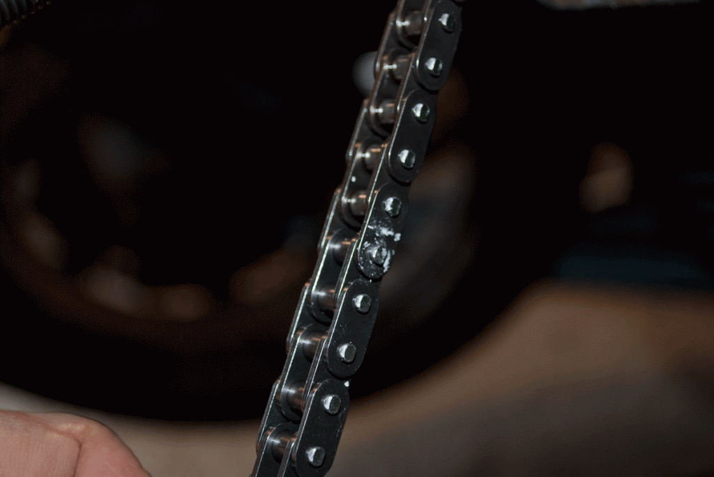

Take the head off, use the splitter to break the chain and push the pin nearly out. Forget about the timing at this stage, just ditch the cam cog and worry about that later.
Then join the old to the new by pushing the pin back through. Mark it with a dab of paint.
Then just turn the engine over and feed the chain through till the marked link comes through
Push the old pin out and push the new pin through. Hold a lump hammer on the back and smartly tap the head with a centre punch to flatten it a touch. Ignore the captured timing cog here - that was me trying to be clever but the timing doesn't work exactly as I thought so its easier to remove it then set the timing later.

So, had the chain stretched? A little, maybe 2 mm?
But the lateral play was much more evident. Here is the old one
and here is the new one
Please excuse what might come across as a 'teaching granny' approach. It may have been explained before but I couldn't find it. The chains are obviously sold as continuous and it would be a nightmare job to change them 'properly' but an hour a side and a bit of confidence it all it takes. As I said before, this might all end with metal bits sticking out in weird places but it was an interesting experience none the less:thumby:
