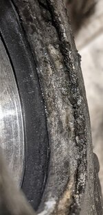

Wait till you ride in winter! Just a "Couple" of examples of what I had in to "fix" :blast and what I finished with :D
"Usually" Stripping the callipers and removing the salts and making sure the bits are as spotless as possible and plenty of rubber grease in the grooves before assembly to prevent salt ingress (If there's no space it can;t get in there)
Good Luck I would probably pull them apart clean the grooves and boil the seals in hot water with a COUPLE of DROPS of fairy liquid and see if that shrinks them again (Warning Warning Probably best not to use Misssus' best pot for this!!)
But a bit of elbow grease and hard work and ....

But have probably reached the pinnacle of abused calipers with these bad boys !!
Probably not been in these for 3 or 4 years from I last serviced this bike
Thankfully I had the Alloy AntiSeize paste on the the little allen bolts that hold the shield on
Bottom line is IF you ride a bike in winter a cleaning of calipers is a bloody good idea No matter if they are Brembo or Tokico
