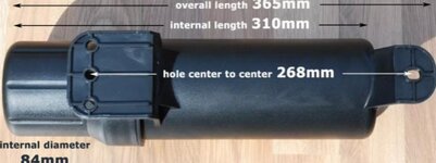

Caesi Registered user Joined Apr 12, 2015 Messages 171 Reaction score 0 Location London Jun 27, 2017 #1 Looking for ways to put one of these tubes onto the pannier racks of my GSA LC. Preferably without having to use a drill. thanks Attachments Tool Tube_GSA.jpg 24 KB · Views: 347
red1 Well-known member UKGSer Subscriber Joined Nov 5, 2007 Messages 2,016 Reaction score 2 Location Lincs, England Jun 27, 2017 #2 P-clips From the dark side this was sent
snaponphil Well-known member UKGSer Subscriber Joined Dec 1, 2007 Messages 1,501 Reaction score 0 Location Lincolnshire, Nottingham Jun 27, 2017 #3 Ebay.. Attachments IMG_4377.JPG 168.6 KB · Views: 391
Marks adventure Through life UKGSer Subscriber Joined Mar 9, 2005 Messages 2,035 Reaction score 3 Location Hertfordshire - England Jun 27, 2017 #4 P clips is the way forward
snaponphil Well-known member UKGSer Subscriber Joined Dec 1, 2007 Messages 1,501 Reaction score 0 Location Lincolnshire, Nottingham Jun 27, 2017 #5 18mm is the size, I ordered 18 & 19mm, the larger ones fit but are a tad loose.. saves wasting ££
Caesi Registered user Joined Apr 12, 2015 Messages 171 Reaction score 0 Location London Jun 27, 2017 #6 p clips it is. thanks guys
