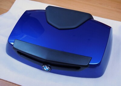

The key here is rated by who! The BMW top box is rated as they have carried out load and speed and stability testing etc. If you read the handbook, BMW do not rate the rack to carry anything other than their top box. So if you put a givi or any other box on the rack, all bets are off as regards the manufacture warranty or liability. This is a manufacturers cover their arse scenario. All pretty much do the same. The rack on its own, if it can carry a 21kg top box plus 5kg loading can manage other loads. But if BMW don't supply it, then they are not responsible.
Try and find a second hand bmw in my opinion it matches the bike
I have used the same top box on two bikes, think it cost me £50 to have it sprayed up and the dealer did the lock barrel change
My own view is given I wanted a decent storage area for touring, I decided against a small top box and instead prefer BMW's own large rear box which can easily accommodate two helmets. It also means when touring I can go out for a ride without the panniers fitted and still have enough storage for things like first aid kit/puncture repair kit, my lid and space for WP's and to store my air vest in when off the bike. My preference if I hadn't already found a bike with it fitted would be to find a good used example. Any colour would do as you can always match the est of the bike by painting it. I also like the BMW one which has an interior light and benefits from a high rear brake light and central locking.
Thanks all. I can’t find a 2nd hand BMW 28l box for sale on eBay or amongst local dealers, so I’ve been round to a friend’s house and had a good look at his 28l top box and a chat about his experiences with it.
I’ve decided based on all the advice I’ve had here and from him to get rid of the Givi plate fitted to the rear rack and to fork out for a new BMW box. It seems terribly expensive for what it is, but to be fair it seems far more sturdy than the Givi boxes. I suspect the latter would be ok at UK speed limits, but as I’m off across Europe soon, I’d rather have the confidence in my luggage to ride faster on the autobahns if the circumstances permit.
