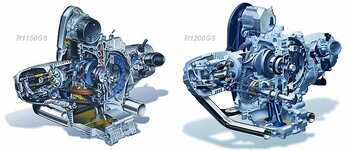

"Camhead" - must be a South African moniker?
I thought the difference between the 2004-2009, and the 2010-2012 models was that the first had one camshaft in each head, and the later had two camshafts in each head?
That said - I've not had the covers off either model to look........ :blast
Al
Nope - the '04-'09 oilheads, like their 1100 and 1150 predecessors, were a cam-in-head design, whereas the '10-'12 bikes were a true double overhead cam design.
Thus.....
So - like I wrote------------one has a single cam in the head................
and the other has two? :nenau
An engine which doesn't have a camshaft in the head is generally referred to as a "Pushrod" engine?
Sure - the latter can further be defined as "DOHC", but I still don't get the "Camhead" moniker as a way of distinguishing the post 2010 engine.
Of course none of the above is true when applied to a 5.5 cylinder three-stroke :rob
Al :augie
i think the old engine is a "high cam" design. the cam is alongside the valves and it has pushrods to operate the rockers.
the TC is an overhead cam design with the cams mounted over the valves.
They are misleading monickers... but they help when telling the difference between one and the other.
Single-cam = Hex-head.
Double overhead cam = Cam-head.
So - like I wrote------------one has a single cam in the head and the other has two? :nenau
Strictly speaking, the hex-head is an OHV (overhead valve) design, as the cams are connected to the valves via rockers and short pushrods.
