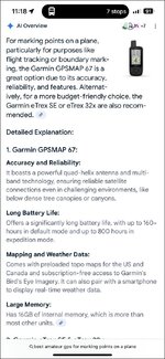

If you have an outdoor satnag, you can chose the option 'Waypoint averaging'
Screenshot_20250722_105730_Gallery.jpg and let it carry on and strut its stuff.
Then using OS maps, you can load the results on the map and see your waypoints relative to boundaries etc.
Job done. No stalking of old codger required!
It’s AI’s answer, so it’s probably bollox…. But it mentions dense canopies of trees….
