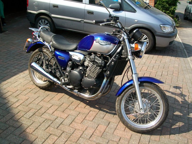

This is looking so good and I'm genuinely impressed with the quality of work going into the build :)
It's also, the first 'modern' Triumph triple I've seen that I'd really like to own. Looking forward to seeing more!

I'll have a slot available for another build once this one is finished ;)

What is important is that the bike prompts people into a reaction, good or bad doesn't matter. If the bike blended into the sea of GS's, Fireblades and Bandits and didn't get noticed, now that would be worse than any negative comment!
.........What is important is that the bike prompts people into a reaction, good or bad doesn't matter. If the bike blended into the sea of GS's, Fireblades and Bandits and didn't get noticed, now that would be worse than any negative comment!
Absolutely, it's the impact of the subtle changes that are so surprising. The chopped rear is so obvious that it draws your eye immediately. Likewise the bars. It's only when you look longer and with more care that the rest is noticed.
You need to find a donor clone to park the project beside for a before and after shot, that would highlight just how changed the bike is.
Jeez this is just more and more impressive.
It's no wonder the people whose HID lights you install are always impressed - it's like getting Michelangelo in to paint the kitchen ceiling...:D
