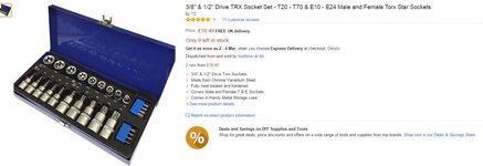

I got these from Amazon... absolutely perfect :beerjug:
