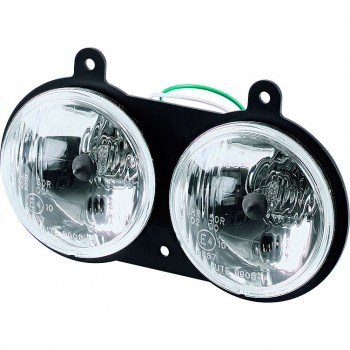

Twin Headlights for GS100 PD
Have you considered the Hella 90m modules? Available in 12v Main/Dip beam Halogen, Xenon, etc..........
Have a browse through the Hella catalogue - search via 'Universal', then select 'Lights/Signal System', then 'Headlight / Parts', and finally 'Headlight'.
Then click on Hella under the Brand Selection - et voila :D - fill yer boots........
Twin headlights plus spots during my airhead fad, the lights were abismal should have changed them for HIDs and been done with it:)
I got my doubt that the standard airhead alternator can supply enough for 3 lights :(

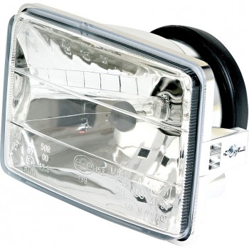

One big one like this works fine...You cant beat a decent reflector

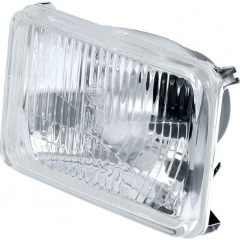

1, As I've done on my truck which also has poor lights (to put it politely) even though I've replaced the original rectangular headlamps with clear polycarbonate lamps with better reflectors is to supplement them with a pair of fogs wired in with the dip and a pair of drives wired in with the main beam (see photo below). On a GS it could be powered by using a 35watt HID in the headlamp and then 35watt HID's in the fogs/drives, total power required would then be 105watts on main or dip. Not a cheap solution I grant you but what price being able to see?!
