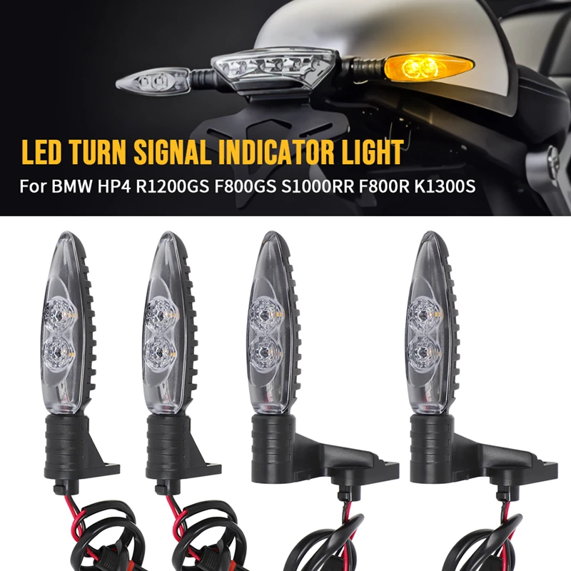

I just found this on AliExpress: £6.63 | Front Rear LED Turn Signal Indicator Light Blinker For BMW R1200GS F800GS S1000RR F800R HP2 Sport K1300S G450X F800ST R nine T
I’ve used these on a few bikes.
Plug and play not loose wires.
The quality is excellent.
