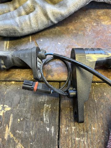

Just attempted to fit my replacement, much easier than the front, 2 screws release the undertray below the rear light cluster & there are two connector blocks accessible beneath the rear seat. Strange design of plug, the large end is too big to go through the wire hole so you have to unplug an adaptor socket to get the indicator off. Anyway been sent the wrong indicator which has a mount foot approx twice the size of mine despite it being advertised as for a gs1200 2013 on. Hopefully get the right one next time.
Thought there was only two sizes , the GS uses the same short stemmed ones both front and rear whereas the GSA has short stemmed on the front and extended stem ones on the rear (although you can fit the short ones on the rear as well to keep them tucked further in )
Is the one on the right for a GSA?
