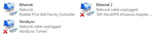

Windows key + X, then press "W"
Click on “Change adapter options”
That will show what adapters are available/in use.
If you only see one called "Ethernet", its probably not installed correctly. If its "X'ed" its not active.
