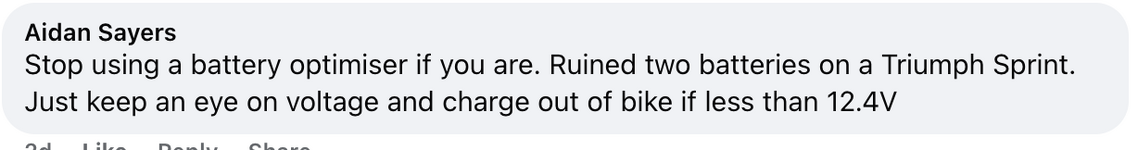

Saw this comment on a FB thread ref poor starting #startsmassivedebate :D
Interesting you should post this as the Techie said, “Leaving the Trickle charger constantly attached is no good for the battery.” I said that’s not my strategy as only once a month it gets connected for 8hrs or so and then disconnected. I’ve always done this and has always worked for me.

Its not recommended to have any battery constantly on charge as it will damage the plates over time, batteries are at their best when charged & discharged.
If you are using an optimate constantly it will sulphate the plates slowly and shorten the battery life. Its far better if not using your bike to put the optimate on for 8 hrs once a month.
Err no. A fully functional current range optimate or any other maintenance (that's a key word) charger, can be left connected indefinitely. These only (another key word) charge when the battery requires it, the rest of the time the charger is monitoring it, not charging it. Old batteries required or in most cases preferred discharge charging as they suffered memory effect, all modern batteries don't. Yes, if your maintenance charger is no longer maintaining and constantly charging, then yes damage is likely, that being shortened life. Earlier Optimates (15ish yrs ago) didn't charge as well as they do post that and the later types are even better at monitoring. Most batteries fail because either they're not maintained correctly, have some kind of parasitic drain, that is allowed to drain it below what can be recharged without there being cell damage/loss, over charged by using a faulty and/or incorrect charger e.g. car chargers. Very few quality batteries will just fail, some will but not many.
