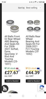

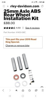

Bearings feel ok although if I did change them myself I would need a bearing puller. I looked on YouTube and presume i would need this ? Plus the front unless Doris you know of other options ?
I don’t recognise the kit. But it appears to have stuff you don’t need? For the rear you need 4 bearings (3 non/abs and 1 abs). 2 for the front ( 1/1)For the cost of postage, you can borrow the right tool for the job from me when you’re ready.

Great thanks. Harley bearings or another make ?

Yes 1 abs 1 non-abs for front. I use whatever bearings the lads bring. I suspect in this case they’re all made in china.
I'd say get them in a local bearing suppliers. I tend to use SKF, Koyo, or Timken. Probably get them for less money than the All BAlls ones and likely better quality.
I agree, contact a local supplier. They''ll probably have them on the shelf and you can choose a quality brand. You just need to read the size from your bearings.
