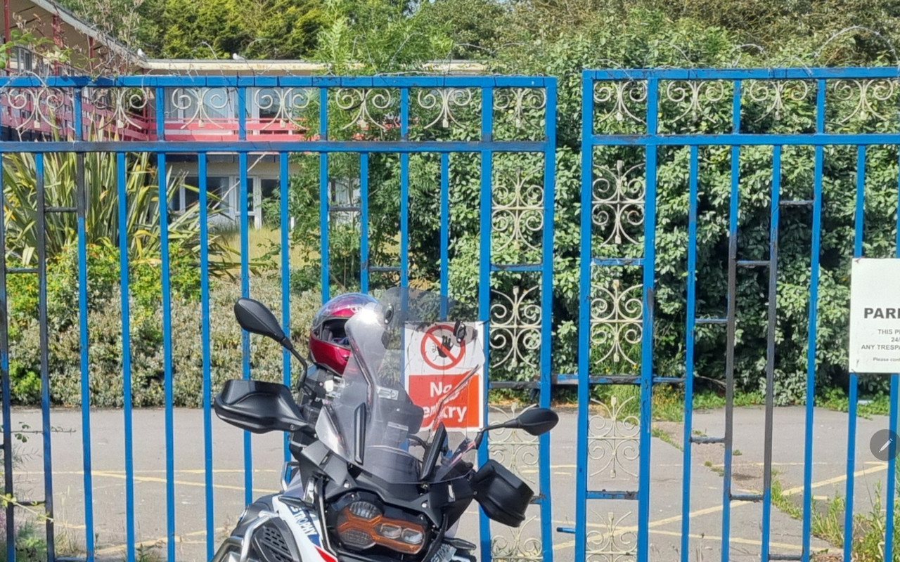

I successfully used this on my GSA to increase the effective screen size without recourse to a larger screen; pretty unobtrusive yet effective 👍🏾
