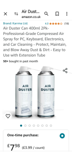

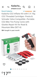

Blast the ignition lock with compressed air when you first park the bike after riding. This should clear the water out of the lock before it freezes.
There's lots of products about on 'tinternt.
