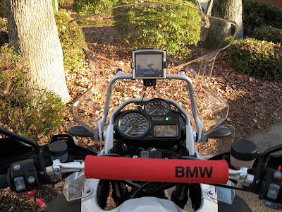

I am in the process of wiring in my tom tom rider into that socket / connector under the yoke. Now the connector block that fits in has 3 wires for connecting an auxiliary device but the Tom Tom only has 2 leads, how do I know which of the 3 leads match up to the Pos & Neg of the Tom Tom lead ?

look on the back of plug block and you will see numbers.
3 +, 2 spare, 1 -
the plug block on the bike.
numbers are tiny so look closely.
if in doubt buy the bmw connector that plugs into it, this will have 3 yellow wires which are numbered.
He's right.
The numbers are tiny, looking like little black marks.
look carefully, they are there.
Thanks for all your help, I do have the proper connector and a friend has just sent me this file which might be handy for others.........
Oops, cant attach it as its too big so have uploaded it HERE

All wired in now ta......
I noticed with my magnifying glass that the 3 yellow leads also have the smallest of numbers on that relate to + / -
