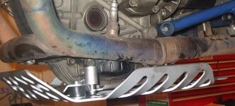

Simple to fit. about 20mins:D instructions can be found on the W-Lich site
Put the rubbers on to the Plate All my Bolts have been copper slipped so there is a lack of seizing:thumb2
Before fitting to the bike clean your threads with the correct tap:rob this gets all the crap out and hopfully will mean you dont cross thead anything makes life that less fraught:mmmm
All my Bolts have been copper slipped lack of seizing when I do a oil change later:eek
Front spacers next to the oil filter
Arrr the little spacer and the 6m allen key opposite
to the oil filter
Now the fixing plate is attached to the sump in the new fixing positions + the long through bolt, you can start to fix the bash plate.
The rear attachmant
rubber bush and spacer
Here it is fitted
So what do I think. nice and easy to fit and well made.............:ymca but as GAY as a turatat part just about right for a GSA but not a balls out HP2E with out a cat:(
It's about as good as a chocolate fire guard it's a ferkin mud shovel:pullface
Just look at the over hang at the rear where the cat was it looks like the JCB backactor:D
It's just waiting to be ripped of the fixing plate to the sump at the rubbers when the bike digs in the mud:blast
HOW WIDE Paint the bike red and white fit orange flashing beacons I'll have to get somone with hazzard lights to run in front of me to warn others coming the other way:( RUTS will have to be avoided:blagblah

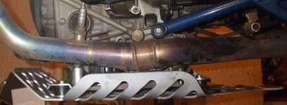

I have the answer
We can bend it weld it make it work for me:JB
Bend the tail up and out the way:thumb2
Cut the sides of and invert them,¬
Ruff markins.
All in all I picked it up on the forsale section. so nothing to lose by getting the grinder to it so.. watch this space more to come:beer:
Any other Idea peeps:hide
