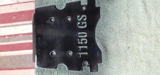

Can anyone enlighten me as to what fittings are needed to attach the centre stand guard?
I have the 2 P-clips for the bottom two holes (either side of the 1150 GS logo) but not the top ones. The top ones have a much wider gap which on appearances wouldn't accommodate a P-clip. Is there another way or different clips to attach the plate to the centre-stand?
A picture of yours (if you have one) would be appreciated so I know what to order.

The part has RSGU2 followed by 25 which is the diameter.

As usual Mr Hartley, you never fail to disappoint me. Thank you! :thumb
I've done a quick search on-line and found a couple of companies that do this particular part although there doesn't seem to be one in a diameter of 25. Can I assume one with a 12mm 'width' will suffice (being approx 1/2 the diameter on yours)?
I doubt a 12 will fit, the diameter of the cross brace on the centre stand is 26mm, hence the 25mm diameter of the fitting.
Try searching for 25mm pipe clamps.
Of course. Clearly maths was never my subject at skool.
