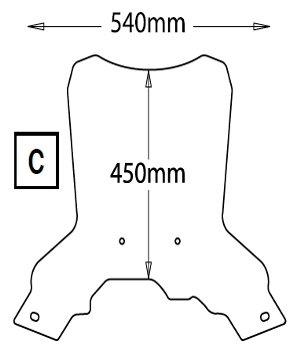

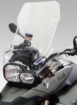

Windscreen ADV Type Highest Protection Full Attack for F 650-800 GS (08')
Hi guys,
I would suggest to try this guys at this link
http://euronetbike.net/isotta/motorcycles/bmw/f650-800gs-08/
Dimensions:
Thickness:
It's the highest you can find around.
Cheers
