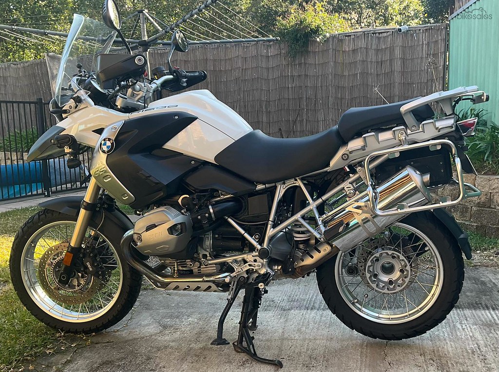

I've found a bike to buy for my upcoming trip to Australia - a 2010 1200GS. Looks very sound, although it's done a few miles - 100K kms. Not particularly bothered by this as my own 1100 has done 140. I've been told that the throttle pulleys might crack on this bike, and I'm aware of problems with the rear Paralever boot, but are there any biggies I should ask my daughter's partner (a biker, but knows nowt about GSs) to look for, apart from all the usual stuff? The bike comes with a GS911 which isn't showing any faults, BTW.

Think I've found the bike, valves or not. The owner passed on a pre sales independent inspection (OK, I know the important bits can't be seen without a strip) and it looks good. Lots of service history and only half an hour from my daughter's place. It only has to last five months of riding! :aidan:moped:
