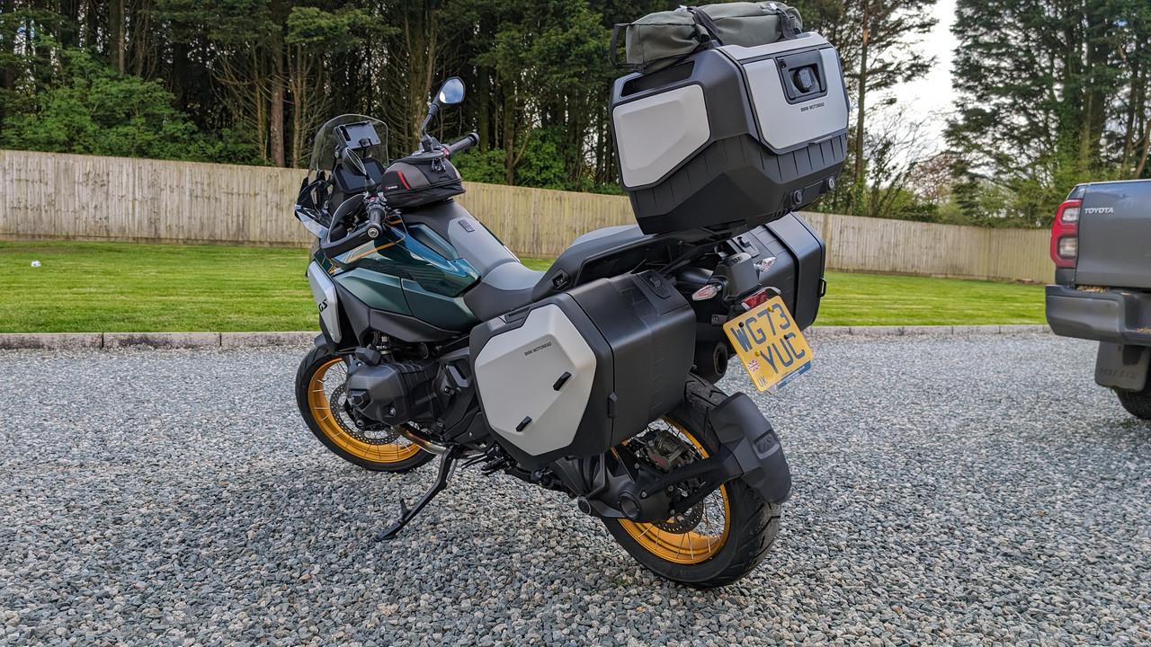

Fully loaded varios ready for first road trip tomorrow. I like the top box but not sure about the panniers, there is a lot more usable space in the top loader options.

I have to say, the aluminium panniers look ok, as do the vario boxes but that top box just looks a bit odd. Love the green n gold colour scheme tho.
There is no problem with the side cases other than the need for some lubricant on moving latch parts. The issue with the top box is that the key can be removed without having the latches locked. A few mindless riders simply failed to latch it properly and pulled the key out . Their top cases did go down the road
I like the look of the side cases, however the left case no longer holds an Arai helmet. The top box looks like a Zerox photo copier. On the 1250 I always rode daily with the top case only , I just can't see doing that with the 13.
