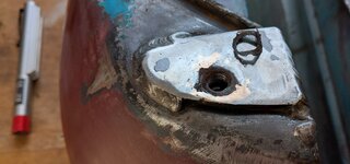

The tank is quite rare being a 3 gallon item for the USA market, most other markets got the bigger and uglier 4 gallon unit. Apart from a few dents it's in really good condition with no internal rust whatsoever, one thing that did concern me though was the nuts that were brazed onto the mounting brackets. This is usually done when the original threaded mounting holes are buggered up by previous owners.
There was no way of knowing how bad things were without first removing the nuts, I had a few options in mind, the favourite being to make up some threaded plugs and braze them in place if the worst came to the worst. I cut off most of the nuts with a slitting disc on the angle grinder.
Then ground down the stumps flush with the brackets.
I ran a 5/16 x 26 tpi CEI tap down the holes to see how bad things were, to my amazement the threads were in excellent condition. The tap also broke free the remaining slivers of the nuts that had been brazed on.
I'm impressed with my angle grinding skills, those slivers were barely 5 thou thick. :cool:
The problem with the mounting holes is that they are only 1/4" deep and the threads can strip very easily. Fortunately the holes weren't stripped but the bolts probably had been at some time so someone brazed on the nuts as a repair. The nuts were 5/16 UNC, a popular American size, the original 5/16 CEI bolts would be difficult to source in America. I tried a couple of CEI bolts into the cleaned out holes and they fitted perfectly, so another lucky day. :)
