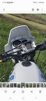

I went to Morocco this year with my set up and it was comfy... it's an old BMW K75 screen drilled and mounted with a Chinese mount thing from Amazon - about £12 - I had another little spoiler on top but this didn't help either way... (no closer pic..!)
