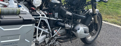

I have had the tank off so many times and dobe a full nut and bolt rebuild but cannot remember where the drains and vent from the filler xap should route. Can anyone help ?
My main concern is the one on the left, which is the drain IIRC.
Here's my right side 2008 GS seems to drop down around the gaitor. I'll have a look for the left. I guess it doesn't matter too much as long as it can drain away from the bike without pooling or snagging.
Here's my left side. I keep a second bike for reference :ROFLMAO: Actually I did have to the two bikes side by side here as I was putting back ECU and associated wiring and I wanted to get it as close to factory as I could. Hope it helps even though this is GS and you have GSA.
