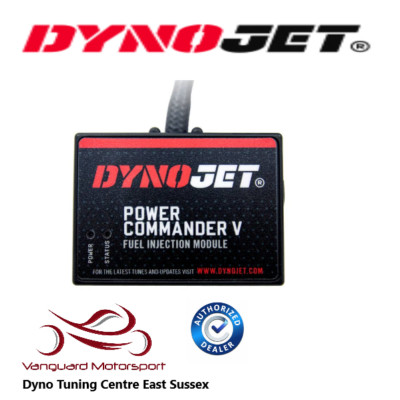

Fresh to the forum looking for tuning solutions that will resolve stalling issues on my xCountry. I've got the booster plug, have checked all the sensors, done the IAC/TPS relearn, left IGN ON for 10+ seconds before starting, etc., the whole shebangabang. Intermittent stalling persists and is only resolved by a key cycle after stalling OR doing the WOT throttle reset procedure + a key cycle. My best, last hope is to find a Power Commander to finally be rid of this nonsense.
There are absolutely none Stateside at the moment, but apparently there's a shop in Sussex that has them. However, they won't ship internationally. So I have come here seeking your counsel.

Im also not sure that a power commander will sort it, as it sounds like there is an underlying issue somewhere. I am happy to buy it on your behalf and ship it to you if that helps.

The key cycling/relearn procedure remedying the problem lend themselves to this being a software issue. I'll poke the shop and make sure they have the appropriate kits and I will post back here.

The aforementioned shop (Vanguard motorsport) hasn't responded to my inquiry. I expect that they either don't view their messages or are just radio silent over lack of interest in Yankee dealings.
Here is the link if anyone cares to prod them for a response:
