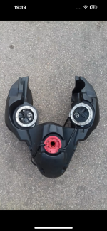

Im just trying to get my head around what further parts i will need, the existing tank only has one quick release connector first image and a breather pipe held in with a crimp.
The GSA tank has a quick release and same electrical connections on the left hand side of the image, then on the right there is another quick release. Im not sure what where this or what i need to plumb in to the new tank.
I take it on the GS we have a pump feed to and from, where the GSA tank has a pump in say on the left and then the right is the return?
I have opened up Real OEM with the GS and then the 2012 GSA (used my old GSA vin) and the images are exactly the same so its not really helping. If anyone can tell me what pipe work i need then that would be great. So first image is my existing fuel distribution on the GS, then last image is the fuel distribution on the GSA. Im thinking i need to source this complete GSA fuel distribution to make it work. Electrical looks to remain the same.

On closer inspection the existing fuel pump has two quick release lines. The rear one is fitted via the rubber pipe. So hopefully that can be swapped to the right hand side of the new tank.. must be the return line.

Don't be fooled by the pictures they are not always accurate representations. But you do need the GSA pipework one as per your last photo, it is specific to the GSA tank. Wiring should be the same.
