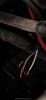

Would anyone know what the three wires on the switch represent?
I was hoping to simply see two wires but there are three. Is it a positive and negative and switch?
Cables in the loom to the switch are: Grey/white - feed from ZFE (active with dip beam on), Black - switched feed to relay. Purple - earth. Note the cable colours in the loom to the switch do not match the colours in the main loom.
The earth is for the tell-tale lamp in the switch.
Many thanks, ah so the light have the ability to switch with when the headlights are dip beam on. So the switch i have then i will need to connect black up to switch and then other side of switch back to grey/white on the loom. The ground i can pickup somewhere under the tank. Hopefully i can source a proper switch, the ones so far i have seen are over £100 for the switch. Hopefully something pops up on ebay over the winter.

So I need to this new switch for live and Gnd then take one of the high beam lights to switch the relay of the aux lights 86 on relay. Would this work?
Thoughts are that the black wire in pic is switched live to energise relay and purple is the Gnd.
Any thoughts?
So for anyone in future this works, you take the white ZFE live via your switch to the black on the switch wiring and this energies the relay from your switch. The purple is just a gnd and part of the harness. I buzzed this out. So all working happy days, now just need to find the bloody switch i bought.
