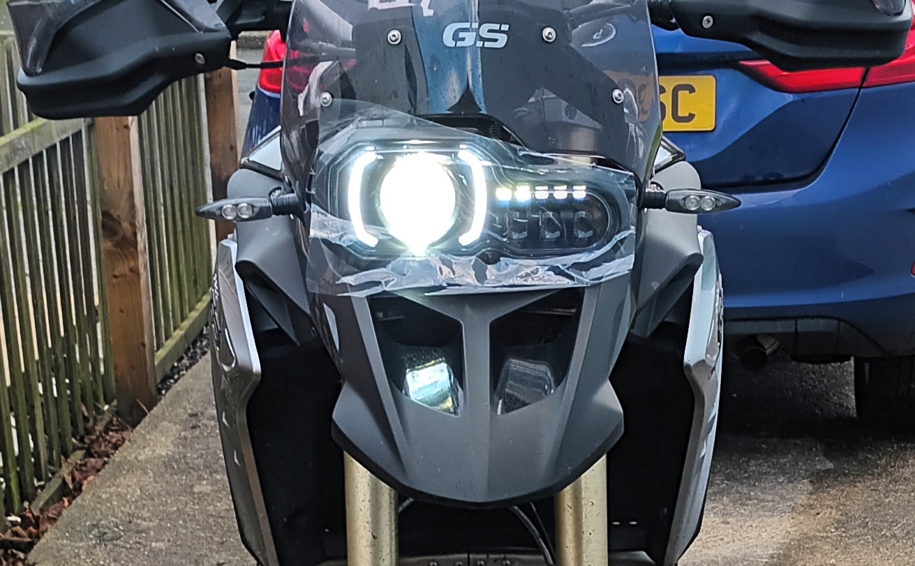

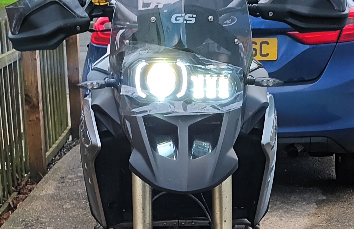

I've ordered myelf an LED headlight from the bay and I've just tried to fit it.
When the ignition is turned on, the surround LED bulb (red line) doesn't light, but once the engine is running, the main beam lights, and the high beam works fine but the dash shows a LAMP warning.... :confused:
Has anyone else had any success with these LED units or have I bought a baddun' ?

I've just tested the suspect LED unit off the bike with a 12v leisure battery and frustratingly the individual LEDs work properly 🤔
I know the cabling and connections are good on the bike as the OEM headlight works fine.

Sounds like it's a canbus compatibility issue then. I would have thought the adaption tech would have been built in to the retro-fit unit.
The seller has sent a new unit to me and it arrived this morning but I've not had a chance to test fit it yet due to a storm. Hopefully I'll get it tested in the next day or so.
As the wind had died down a bit I fitted the replacement headlight unit to my bike and it's got the same issue. Both work fine off the bike, but not when connected to it. I've contacted the seller to arrange the return and refund.

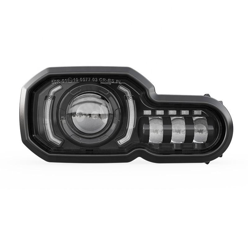

When I was shopping for LED headlights for our two bikes I came across various comments where people experienced issues with that headlight. I opted for the "3rd GEN" headlight instead as it had consistently positive reviews and you could actually obtain the E24 paperwork for it.
Get the one that has the sidelight that looks like parentheses. Available from multiple sources.

Thanks, I've found a seller of the headlight you recommend so I'll give them a try. 🤞
