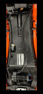

KTM design a bike around a Denali Sound Bomb!
Even the contours match the bash plate
Remove the stock peep peep and guess what, the bracket is perfect for the Denali. As far as I can see so far the stock cables work OKAY on the compressor without a fault on the dash - this doesn’t happen on a BMW!

Well you’ll need to know where I’ve fitted the compressor. One option was to remove the charcoal canister but I won’t do that just yet. So I’ve sited it under the seat on top of the air filter lid, drilled two small holes for cable ties and cut a rubber mat to sit it on. You need to grind the bolt holder off the compressor. Goes without saying to keep the cable/hose off the engine. Hose was exactly the right length to the mm! See pics:

...how do they sound with a big dob of Clay/Turf/Peat on top of them - is that not in the crud catching area? I think the sweet lamb bods have fitted there own purpose made crud catchers there
That’s a great idea. My concern would be why KTM haven’t fitted one from the off as the bolt holes are clearly there for the purpose. Just need some captivated nuts fixing to the aluminium plate and 4 knurl head bolts with o-rings (so they don’t vibrate loose) to make it easily removable for cleaning.
I’d want to be sure that heat from the manifold wasn’t unexpectedly causing a hot fuel issue or something else before fitting one. That said, I think some heat wrap on the manifold pipes would sort that wouldn’t it - though KTM wouldn’t send a bike out wrapped would they.
Don’t worry about the Denali being too quiet!
Just to say that using the stock cables for the Denali isn’t the way to go. You need to fit a relay, as normal. Worth a try though
That’s added 5bhp!!!
