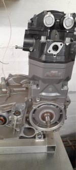

And then @dean0n0 put me onto an unused ‘Swampy’ Marsh breathed on stage 3 engine which I couldn’t resist, and things begin to get out of hand.

Here’s the new engine - yet to be collected:
Here we go again …
Right well I did the deal, agreed the price, offered a deposit ‘oh no that’s fine’. Then went to make arrangements for collection and li and behold the fella selling the engine changed his mind, bless him.
Blimey, when did he last build one of them, is he still around.
