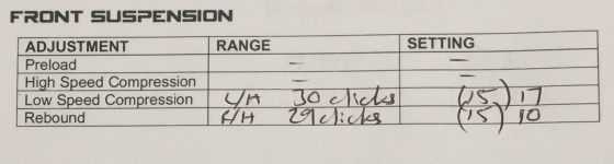

What suspension settings are you guys using on the front clickers? What ever I do there doesn't seem to be much difference. :nenau
I had a grown up set mine, but this is what he did and I've not touched it since.
It will depend on a number of things but, Fat bastard on a 2019 with Xplor forks:
