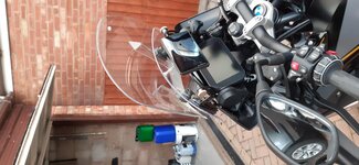

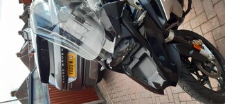

GIVI Airflow
I cured the vibration/buffeting problem on my R1250GS with a GIVI Airflow. I did have to make a custom lower screen though.
