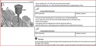

DO NOT RUN THE ABS PUMP ANYMORE!!!
GSophil, the noise you mention is the ABS hydraulic pump cavitating because the internal reservoir within the ABS pump (not the handlebar or rear brake reservoirs) is low or almost empty. Obviously you weren't to know that 'old school' bleeding methods do not apply (learnt that one myself the hard way too on an 1150Adv system).
The ABS pump is lubricated by the brake fluid. If you are lucky you can refill the ABS pump reservoirs and bleed the system properly (NOT the 'old school' way) and you will have got away without damaging your ABS pump. If you run it low/dry you will cause expensive damage to the pump (Over £1000 to replace).
You will need to remove the fuel tank to gain access to the ABS pump, then open the reservoir cover and refill with fresh brake fluid. Then you will need to carry out the bleeding procedure on brakes to be sure that you have purged all air from the ABS pump and brake circuits, as per the link that KTMMark has provided.
It may be easier to get the dealers to do it if you have a way to get the bike to them. When I cocked up whilst bleeding brakes on an 1150Adv, the dealers (generously) charged about £70 to refill and bleed/flush.
I'll second that.
