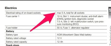

From the handbook ;
Handbook of a 1200 - this is the 1100/1150 technical section ..... 1150 socket is fine for a heated jacket, been using mine for a Gerbing heated jacket and temp controller since 2005 :D
Dont quote facts Steptoe!
ok ...many apologies , my error . So sorry . Hope it powers it ....
