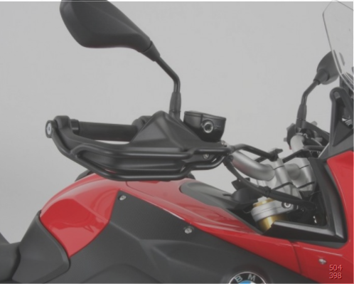

Right back to my handguard issues (can't find where I posted it) but basically the extra metal clip that stops the left hand parking brake from hitting the handguard, dislodged a small micro switch that moves in and out of the switch housing, turning the dash parking light on/off. Anyhow, I took it in to honda and they replaced the switch FOC and at the same time installed my koso grips. I asked them to rotate the grips so the switch would not impeded the paddle access on thumb side. So they installed it directly inline with the indicator switch. So it has to go back. After using the bike for 1 day, I used the parking brake once. Soon as I released the parking brake, the parking light stayed on again. Told Honda and they said they'd look at it at the same time as they fixed the heated grip. Got a call today to say the barkbuster metal thing is causing the switch pushrod thing to bend and it requires a new switch. I can honestly say I used the hand brake once, so I don't think Honda tested this before I collected. Anyway, seeing as I damaged the first one, and now another one has gone, I am wondering if the metal thing from BB is bent/not in tolerance? Also that I am liable for the new switch that's now on order. So has anyone else had a parking light issue when installing the BB guards?
