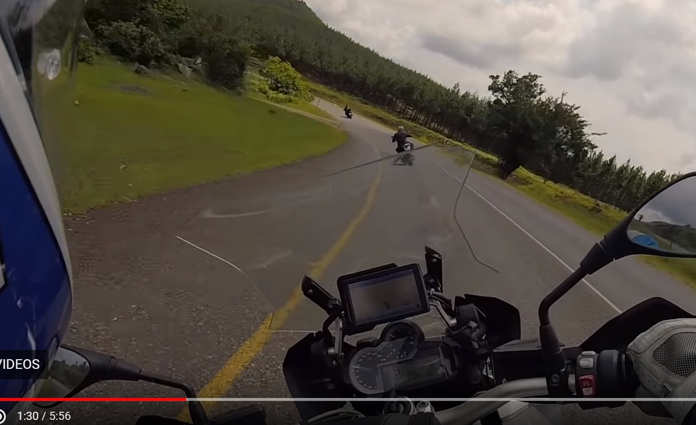

What do you think of this?
He says:-
Over last few months I have re-edited this video many times. As much as I love motorcycles, riding and all that goes with it, seeing the video in fine detail over and over again would make me very uncomfortable. It's very expensive lesson I have paid - I hope many of you can benefit from my experience.

Got to 0.15 and my conclusion was 'wanker' :D
But looking at the incident itself quite worrying. Or is there something we're missing?

Well I have a theory on this.
He's turning the handlebars into the turn, not counter-steering.
He's also not light on the bars, he's got a firm grip from the pictures.
So if he's got to the end of the tyre grip, and forced the steering inwards for more lean angle, it's lost grip and all hell broke loose.
Once he stood it up, why didn't he throw it back into the turn once it'd stabilized ?? He could have saved that.
In my opinion.
Nope;
Too high a gear for speed, wrong position for the corner, looks like they hit a worn patch of the road and it kicked back.
As for the tankslapper, if he'd relaxed a bit more...
The lack of brakes is caused by the tankslapper knocking the pads back in the caliper, couple of quick squeezes they'd have been fine.
If your pegs ain't touching the deck you can lean it over further, but by now it is target fixation.
I may be incorrect here but the lean angle as he approach the corner may have caused either the foot peg or boot to collide with the tarmac too as at 01:30 it can clearly be seen to kick out which he pushes back against into the corner.
Inexperienced rider...I don't care if has 15 years behind him...his line into the corner was awful, gear selection poor (55mph in 5th when possibly 4th would have given better drive out of the corner with a slower approach speed in), he was tensed up and as soon as that tank slapper started he was fixed on the point he eventually crashed. Panicked, hit the brakes to find nothing there and then chose his line to crash into. I'd like to say that wouldn't have happened to an experienced rider and for the most part, it wouldn't, but these things sometimes happen when we least expect it purely because we're not switched on enough at the time and he clearly wasn't.
Those tyres are more off road tyres...if he spent more than 20% of his time off road, fine but I'd put money on him having most trips on tarmac. Use road tyres would be my preference (or at least adventure tyres which are more road biased). Point nr 2, anticipate the corner and choose the correct line and gear well before the corner and not have to correct mid corner. His line of entry ought to have been out towards the central line not tucked into the left where any increase in speed would have pushed him wide anyway into that long bend and not given any chance to correct had he needed to (as he found out). He couldn't lose any more speed partly as he had no engine braking = too high a gear.
Last point is don't panic. He did.
I also think he's over analysed the whole thing massively, possibly due to the severity of his injuries and he discounted the one thing from early on which I think is his main mistake. He discounted rider error. A combination of being on the edge of chunky off road tyres at high lean angle and possibly hitting a bad patch in the road or grounding something massively contributed to that accident imho but the main problem was his own riding. Until he can see that, he's never going to regain his confidence and the chances of him having another accident are higher than if he learnt from it, improved his riding and moved on.

To be fair, we have the benefit of that video so it's not just a case of "idiot must have lost it on a corner". It's pretty clear why he came off, just not apparently how it was triggered. Whatever the cause, his line in was a massive contributing factor as was gear choice, lean angle, loss of braking and control. 9 times out of 10 he might have got away with it, this time he didn't. I'm sure we've all cocked up in the past and thought ourselves lucky to have got away with it too, and videos like this just reaffirm the importance of defensive riding (even for faster riders), choosing the right lines, appropriate speeds and trying not to put yourself in a position where risk of accident and injury is increased.
