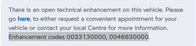

Just checked mine (May 2023 R1250GS). It has two outstanding recalls:
There is an open technical enhancement on this vehicle. Please go here, to either request a convenient appointment for your vehicle or contact your local Centre for more information. Enhancement codes 6612900000, 0046630000.
Anyone know what the other one (6612900000) is - or how to find out?

Just checked my 2020 R1250GSA and this came up:-
There is an open technical enhancement on this vehicle. Please go here, to either request a convenient appointment for your vehicle or contact your local Centre for more information. Enhancement code 0046630000.
I guess that is related to the circlips, as all the other recalls were completed prior to the dealer releasing the bike to me.
I checked mine just now and got the same message.
Any document or URL to find recall details : models, production dates, ... ?

Just checked my Oct. 2022 R1250GS, and got the message about enhancement 0046630000 required.
