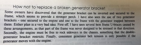

Interesting mod to fit the dynamo. Two tapped holes in the crankcase and you can mount the dynamo on a later engine, though they do indeed come loose. There is some issue with mounting them on the frame, but I've never seen one and can't remember what it is. I'll have a look in Guzziology.
Loops fetch strong money these days, but bear in mind that later Tontis are much better dynamically and parts are more plentiful. Loops arguably have more character and are generally reliable despite not having an oil filter.
Thanks for that, and the PM’s. I have asked for more pics including the dynamo area. It would be most helpful if you could let me know if Guzziology has any info on the mod because if it is thought to not be good practice that would rule the bike out for me I am afraid.
