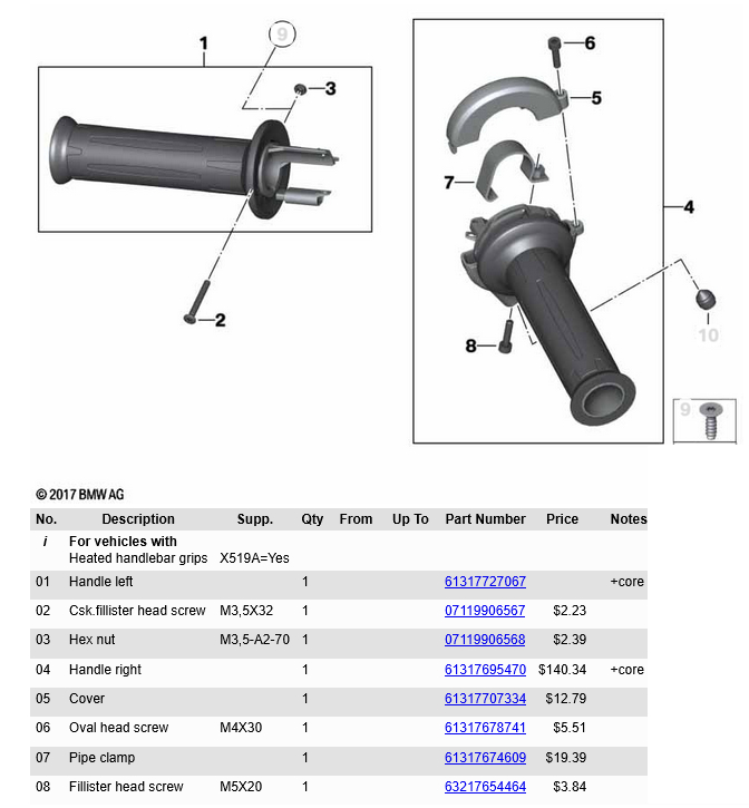

Im wanting to see if anyone by chance has a picture you would have taken of the throttle side heated grip off the bike?
Reason i ask, i see a lot of them that mention various part numbers, when you view the image its like the actual clamp piece is removable from the actual grip frame if that makes sense. So when i search for the part number for my bike its 61317695470 but there are lots on ebay that all look different. They cross to looking the same as those off an F800GT to those from an R9T and so much.
So there are some around £40 as opposed to the £150 its going to cost for the proper one.
I will try and remove and see if i can fix it but at £40 im thinking i might opt for the one off the F800 and try.
So if there is a pic that be great, or if you know does the fitting of the clamp remove from the end of the throttle?
Some are like this:
Then some look like this
Which is it, with the plastic section out the side of the lower image is this removable at red arrow, could i use this and transfer to one that looks the same as the top image?
Thanks

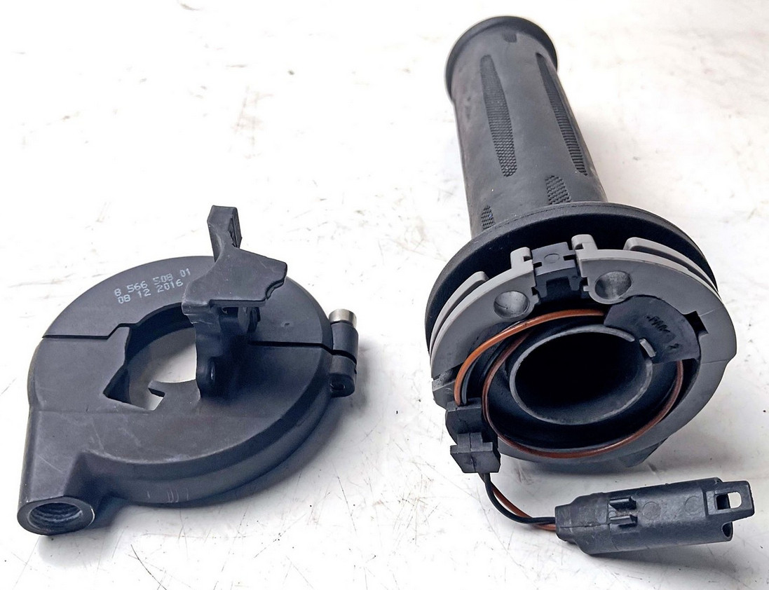

three parts and the metal housing
the electric element
the plastic twist grip sleeve
the rubber grip
I forget if the metal bit comes with it (I think so) but you don't need it - it doesn't wear - the issue is on 2007 or earlier bikes, BMW like to try and kill riders blocking the brakes with throttle cable
later bikes got the cable running out the top of the metal bit and riding above the brake lever
I believe you must have the correct metal bit to go with the correct grip sleeve - I have a brand new old spec heated grip doing nothing as I like to slow down, and it became superfluous when I upgraded it to a safe bike
here is the metal bit off a ninety

I suspect it won't fit as the cable entry is very different and thus where it all sits moulded to the sleeve vs the metal housing will be x degrees wrong
have you checked youtube for repairs - those with soft solder and some skills peel back the grip and solder the fragile bits that deliberately come adrift
