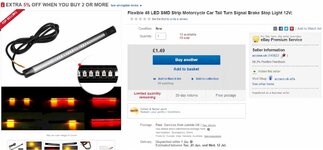

I bought my rear LED Brake Lights from eBay. Came from China at £ 1.50 each.
I was going on a 4 day tour with panniers, so I bought a handful and will treat them as disposable.
But in fact they worked really, so left them on the bike.
I originally just stuck them onto my number plate. All my biker mates liked them, so they are staying for now.
HEX EZCAN controls the brightness. So they are on 10% during normal running lights, and 100% on brake lights, which match the existing lights perfectly.
:thumb
